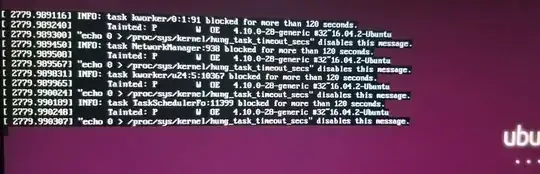

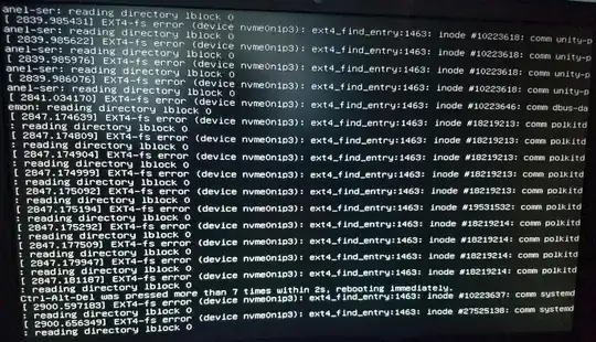

Here's what my screen looks like after I hit ctrl+alt+F1
ctrl+alt+F1
Is this a known problem for Linux on nvme drives or was there something I had to do extra besides install it?
edit: Here's a picture of a recent attempt of trying to shutdown and the message I get on screen.
shut down

  • 409
This looks similar to the issue reported here (EXT4-fs error after Ubuntu 17.04 upgrade), which appears to have been resolved by partially or fully disabling the APST (Autonomous Power Saving Transition) features on the drive. Try adding nvme_core.default_ps_max_latency_us=5500 to your kernel command-line parameters and see if that helps.
