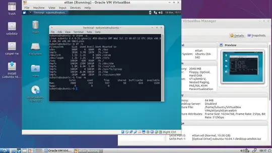

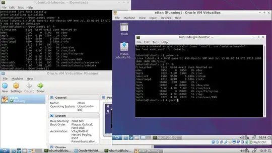

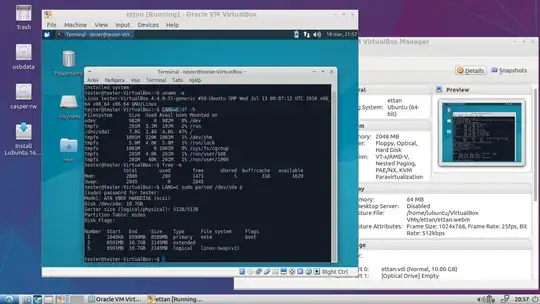

When testing VirtualBox in a persistent live Ubuntu based system
  • some version may work better. I tried 16.04.1 LTS created from the Lubuntu desktop iso file lubuntu-16.04.1-desktop-amd64.iso
  • I installed virtualbox from the repositories with
    sudo apt update
    sudo apt install virtualbox
  • I selected a suitable 'internal environment' in VirtualBox to match the guest operating system, that I wanted to run,
    • 'General -- Basic -- Version: Ubuntu (64-bit)
    • enough RAM (2 GB in a computer with 4 GB)
    • connected the virtual optical drive to an iso file
    • created a virtual disk
    • and installed Xubuntu from xubuntu-16.04.1-desktop-amd64.iso
This screenshot shows the installed Xubuntu system in VirtualBox. Click on the screenshot and and view it in a big enough window to see it at full size.

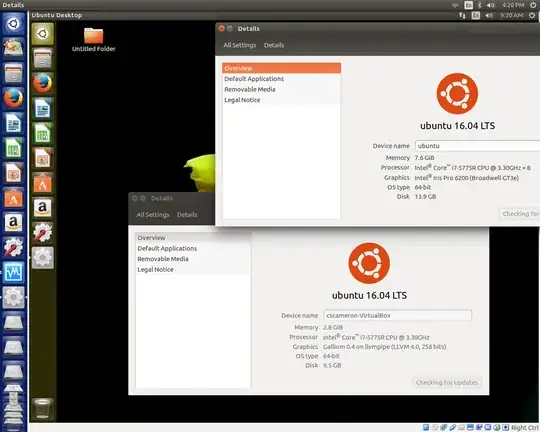

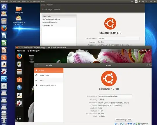

I made a Persistent USB using mkusb and installed VBox from the repositories, sudo apt install virtualbox-qt.
I rebooted both the virtual machine and the USB several times each with different combinations of OS.
Everything seems to work fine to me, screen shots attached.
I am wondering if the problem could be due to corrupt ISO(s), (check MD5SUM), or the version of VBox.
The version of VBox from the repositories seems smoother than the version from the VirtualBox.org website.
I don't think problems with BIOS/UEFI come into play with virtual machines.
I have also had problems with outdated versions of VBox stop working and requiring updating.
