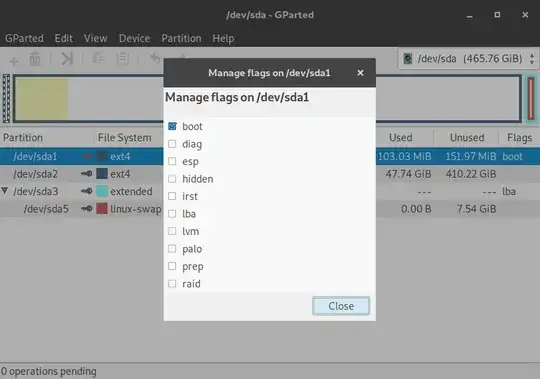

Changing Boot Flag with GParted
Based on the output from sudo fdisk -l, it appears that no boot flag is set on your primary drive. To make /dev/sda bootable, open up GParted and right click on /dev/sda1. Then select Manage Flags and check the box that says boot.
After that is done, reboot your computer and attempt to boot into your primary installation. Hopefully you'll be successful.
Note: Really quick, I just want to explain how I know that /dev/sda1 is where your system should boot from. The first clue is that it's of type /EFI system. The second is the size of the partition being 512 MB. That size corresponds to that of a standard MBR/GPT boot partition.

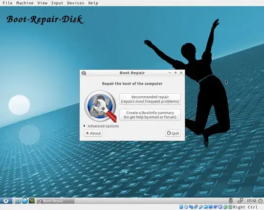

Using Startup Boot Repair Disk (method 2 to reinstall GRUB)
There exists are repair tool that can be installed called Boot Repair. Someone was kind enough to create a live CD/USB version to help systems that are in an unbootable state.
Note: You will need another USB/CD/DVD for this task. Also, all data on that USB/CD/DVD will be lost!

- Reboot your system from the CD/DVD/USB you burned the boot repair disk to. If all went well, it should boot up and beginning scanning your drives and boot configuration.
- You should see this if it successfully detected everything:
- Generally speaking, the default option is fine. However, you can click the Advanced drop down arrow to see a plethora of options to configure GRUB. Some of these may help fix your issue. However, being that you cannot boot at all and have not shared any error messages, I'm assuming that you're simply being greeted with a black screen at boot (if you are receiving errors of some kind, edit your question to contain them). Click the default option.
- At the end of the repair, you should be presented with a pastbin URL. Please write down that URL and edit your answer to include it, as it contains log information and may be useful.
