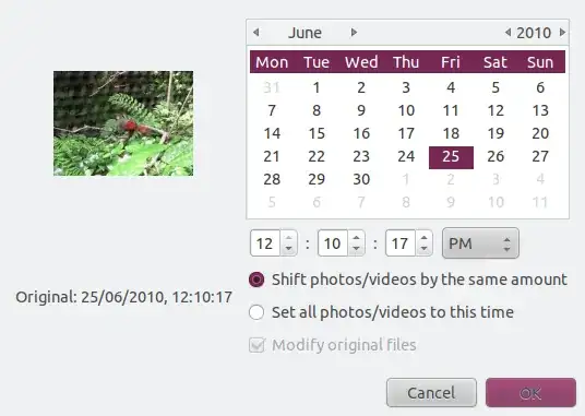

Changing the date and time are easy in Shotwell. Select the photos you want to adjust and go to the menu like this:
shotwell menu
Select Photos/Adjust date and time. That brings up a menu like this:
time date adjust
If all the photos are off by the same amount, you can do them all in one go. If you used more than one camera and they were off by different amounts, you have to divide them and do each batch separately.
Shotwell's help page explaining this is here.
