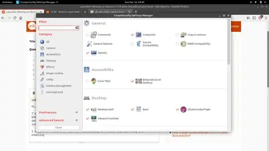

I'm kinda new in Linux environment. I installed Ubuntu and play along with some modifications. Recently I tried installing Cairo-Dock and didn't like it so I decided to remove it afterwards. But then, once I finished uninstalling and reboot my system, my launcher (Ubuntu Dock) is suddenly disappeared.
Screenshot-1

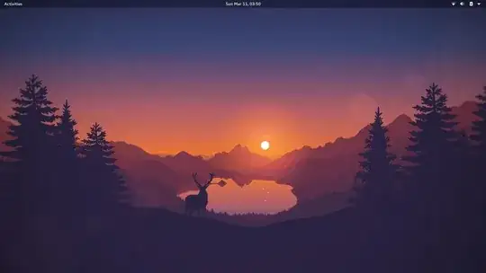

I wanted to restore it back by reinstalling the unity-desktop, removing compiz config, and enabling Ubuntu Unity Plugin thing.. all didn't work. And now I'm desperately wanting to get my launcher back and ended up having no idea what to do any more.
Screenshot-2
Can anyone help me solve this?

Nevermind, i managed to solve all of these by resetting dconf and reinstalling gnome-shell-extension-ubuntu-dock (thanks to @pomsky).
