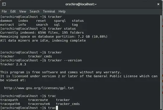

The project page mentions tracker-preferences but I don't have this command with version 2.0.3.

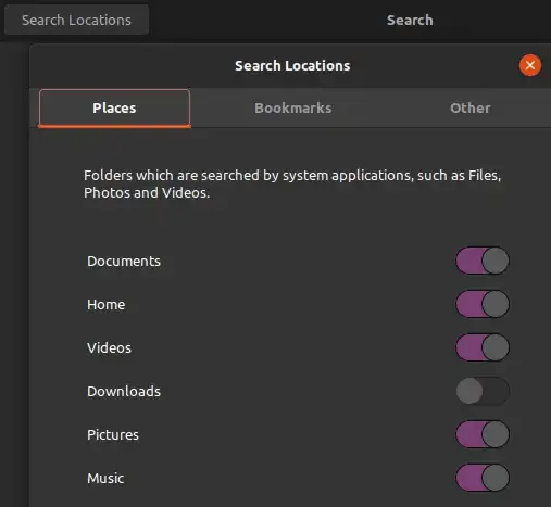

Folders to include in scan can be specified in:
Settings → SearchSearch Locations (button on top bar)
Settings - Search - Search Location
Also you can exclude a specific folder and its subfolders by creating an empty .trackerignore file in the folder.
