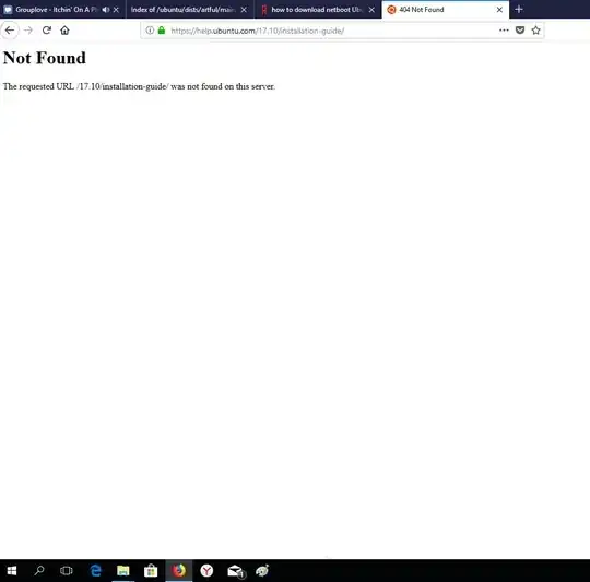

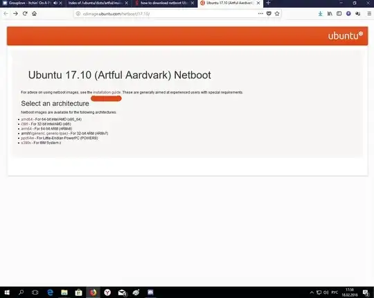

I want to install Ubuntu 17.10 32-bit on my ASUS laptop, but when I tried to download it I got these two screens. Note that these screenshots were taken on my Windows 10 desktop. Is there any other way to install Ubuntu 17.10 32-bit?
Edit: I'm sorry everyone I should've explained myself clearer last night. The thing was, I've read the news about no 32-bit support on omgubuntu site, but it said there that you can still download it. Then I was looking for something familiar I skimmed 64-bit variants for obvious reasons and server because it was vague to me. So I checked to netboot, I saw a tree file and I was like - that's what I need, apparently I just need to download all of those files to the usb and that's it but some of them were like blanks I mean I clicked them but they weren't downloading. So I checked the installation guide - but it lead to 404 mistake so my question was how to make that netboot? Also I'm using Windows 10 on my desktop to download 17.10 to burn USB-stick that I can use to my old laptop on which it ran Windows 7 poorly so I thought of trying Ubuntu Gnome 17.10 because it's new and I wondered if it would run smoothly or not since the change of Unity. I get it that the lightest distros like Xubuntu will be more effective but I kind of dig it to the Ubuntu design. So that's it probably. enter image description here Ubuntu 17.10 (Artful Aardvark) Netboot
enter image description here 404 Not Found
The 17.10 ISO file is 64-bit only. The Ubuntu 17.10 minimal CD supports installation of Ubuntu on computers that have a 32-bit processor.
