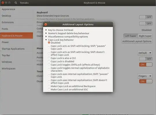

You could try the Gnome-tweak-tool, assuming you're running on gnome, if you're on unity, there is a unity-tweak-tool. Both can be installed using apt:
sudo apt-get update
sudo apt-get install gnome-tweak-tool
OR
sudo apt-get install unity-tweak-tool
in the gnome tweak tool under 'Keyboard & Mouse' there is an option called 'Additional Layout' options, in here you can change capslock key behavior, mapping it to esc, as well as just about anything you want.
Here is a picture as to what it might look like Gnome Tweak Tool
