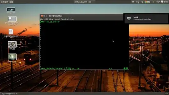

and in /etc/default/locale only US English line was present as you can see this snapshot:
I went to those files and deleted these extra lines of Chinese Language now I am able to resolve this problem and things are back on track.
