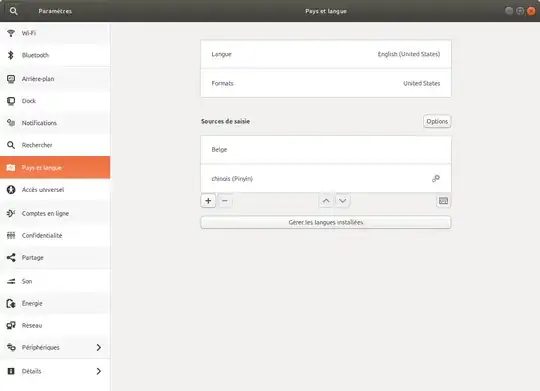

I'd like to change the language of Ubuntu 17.10 to English (from French). I've changed it in the GNOME Settings:
And:
$ cat /etc/default/locale
LANG=en_US.UTF-8
I've logged out and rebooted but everything is still in French (command line prompts and GNOME interface).
Any hint?

Thanks to comments on the question, I checked my .bashrc file and I still had some traces of a previously set locale:
export LC_CTYPE=fr_BE.UTF-8
export LC_ALL=fr_BE.UTF-8
Removing them solved the issue.
