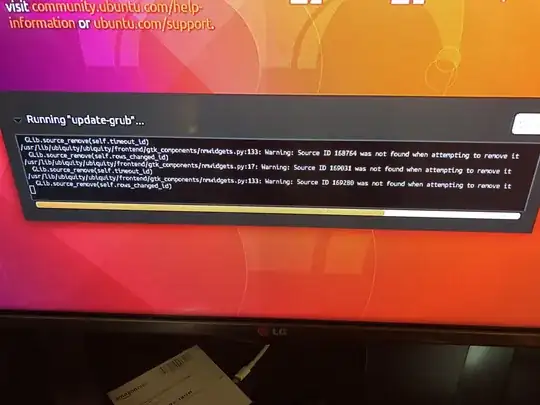

Then files are copied over until the installation gets to "update-grub" at which point it hangs (or more precisely, slows down to a crawl). I let it run for 10 hours before killing it.
Opening up the dialog box reveals a slow trickle of errors, about one every 2-3 minutes.
Screenshot here.

The boot partition is on the SSD (/dev/nvme0n1) while the partition I modified was on the SATA drive (/dev/sda). So I don't think it was the modification of /dev/sda that broke anything per se.
But there are now 2 or 3 boot partitions from botched install attempts, and the only way I know to distinguish between them is their size, so I'm not feeling confident enough to delete them without knowing what they are exactly, but this could be interfering with the install processes, and so making educated guesses at which partitions to delete will likely be my last resort if all else fails.
