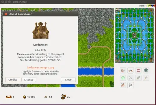

4. Test it out!!
Works well on my Xenial Xerus system:
And hopefully on your system as well :)
