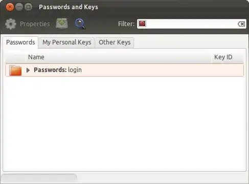

  1. Open the Passwords and Keys (Seahorse) application
    This screen will appear.
    Passwords and Keys screenshot
  2. Either go to FileNew in the global menu or hit Ctrl + N

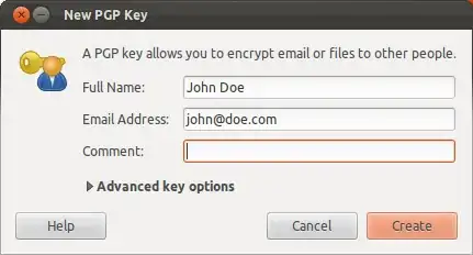

  4. Enter your full name and your email address, the comment is optional
    New PGP key screenshot

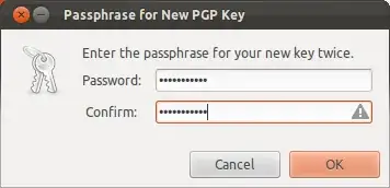

  5. Enter a strong password which you'll remember
    Passphrase for New PGP Key screenshot

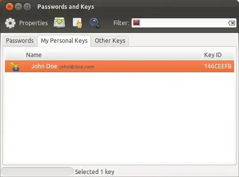

You can find your key in the Passwords and Keys application's My Personal Keys tab.
My Personal Keys screenshot

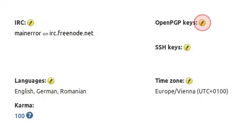

  2. On your profile page click on the yellow edit button (a round button with a grey pencil icon) next to OpenPGP keys
    Note: The URL to that page looks like this https://launchpad.net/~yourusername
    OpenPGP keys on LP

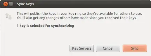

  5. Select your key and go to RemoteSync and Publish Keys in the global menu
  6. Hit Sync

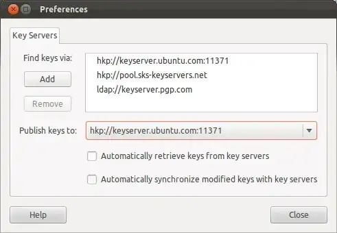

    Note: The Sync button may be grayed out if no sync server is selected. In that case:
    • Hit the Key Servers button
    • Select the hkp://keyserver.ubuntu.com:XXXXX key server from the Publish keys to list and hit close

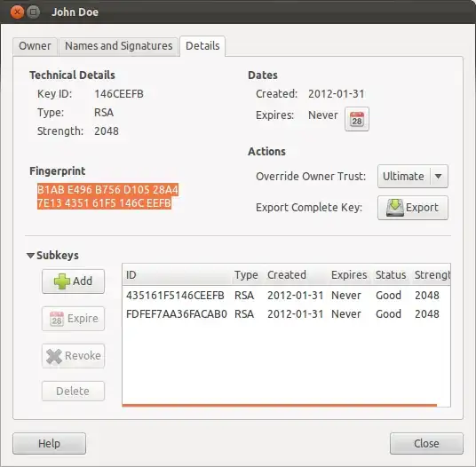

  7. Double click your PGP Key from the list on the My Personal Keys tab
  8. In the key window that just appeared navigate to the Details tab, select the Fingerprint with your mouse and hit Ctrl + C

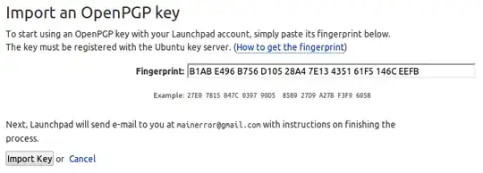

  9. Paste the just copied fingerprint into the Fingerprint text field on the Change your OpenPGP keys page on Launchpad and hit Import Key

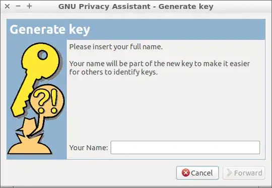

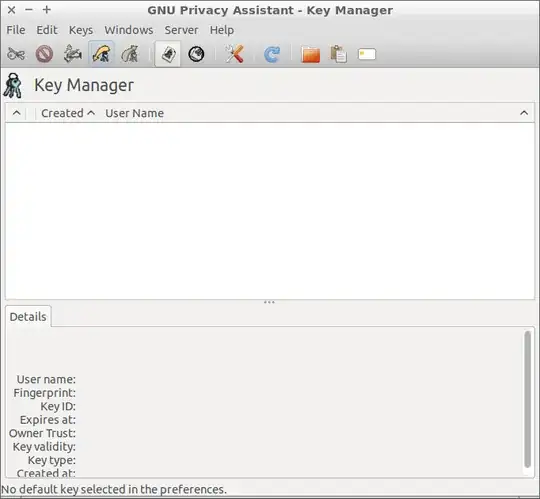

On some systems such as lubuntu where the password and keys (seahorse) app is not available, a good and simple way to make PGP key is using gpa (GNU privacy assistant). It is a graphical frontend for gpg. This method also apply to others ubuntu derivatives.
  1. install gpa
sudo apt install gpg gpa
2.launch gpa from your applications menu
3.Hit the Keys menu then select New Key . you are presented with a new window
4.Type in your full Name, click forward, then type in your geniune email address.press forward. Now select the option to do a backup later.
