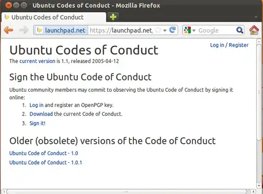

This will open the following page:
All you have to do is following the steps outlined.
  • The first step is not necessarily related to signing the conduct but of course you need a launchpad account first, and you also need to create and upload a PGP key to later sign your agreement.
  • Download the Code of Conduct.
  • Sign it!
You will be guided through all steps you may need to succeed. There are even popups for additional help in case you get stuck.

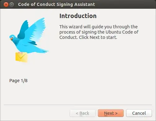

Although the answers given already are great in detail, I'd like to add one of my own. There is a tool that automates the process (including generating a PGP Key): The Code of Conduct Signing Assistant. There's a PPA available and also a separate .deb file.
It guides you through the whole process, so you just have to follow the steps and in the end you'll have signed the Ubuntu Code of Conduct.

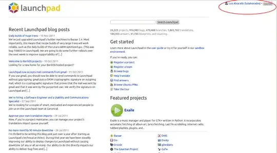

Go to http://launchpad.net and Register an account. After registering you should see something like this:

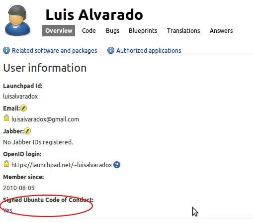

Click on your user account and on the bottom you should see an option that says "Signed Ubuntu Code of Conduct":
In my image it says YES but if you have not already done it, it should give you a link to the Code of Conduct page. If you click on the link it will send you to the CoC page where you can read the whole CoC and Accept and Activate it at the bottom of that page. Before accepting you need to enter your Fingerprint in the CoC page:

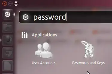

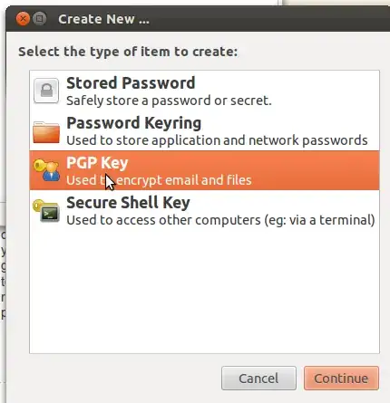

  1. Open the Dash and type password then look for the Password & Keys app:
  2. Go to the Menu and Select NEW. It should open a window where you will select PGP Key:
