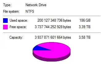

Calculated: (3845577736 - 3650140872) / (1024 * 1024) = 186,... GB
The calculated used space is much more than the reported value.

  • Disk usage as reported by Windows 7 (same as df -h):
