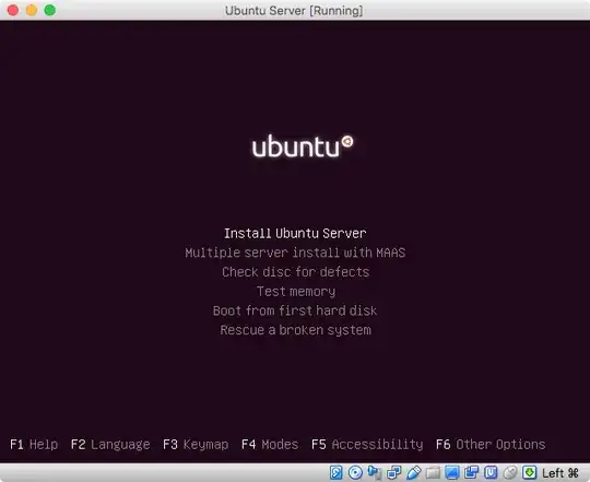

  4. Boot from the DVD. You have not done so already, insert the burned DVD in the optical drive and restart the Mac. Immediately, hold down the option key until the Startup Manager icons appear. Select the DVD icon labeled "Windows", then select the arrow under this icon.
  5. (Optional) I installed using the default installation mode. If you want more installation options, you can enable the Expert mode. When you see the image shown below, you can select the Expert mode by entering the key sequence F6, space, esc, before pressing the return key.
    Note: I did not use the Expert mode, therefore I just pressed the return key to continue.

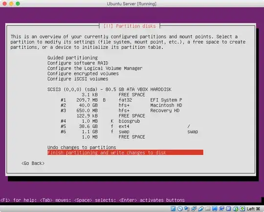

  6. Proceed until you reach the partitioning part of the installation. When I reached the image shown below, I chose Guided - use the largest continuous free space.
    f2

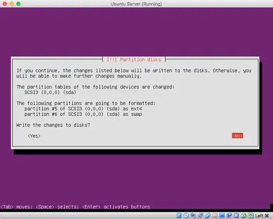

    In the next image, I chose the default <No>.
    f11
    In the image shown below, I chose the default Finish partitioning and write changes to disk.
    f12

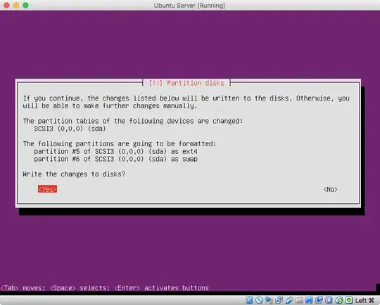

    In the next image, I chose <Yes>.
    f3

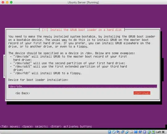

  7. When the following image appears, enter /dev/sda, then select <Continue>.
    f20

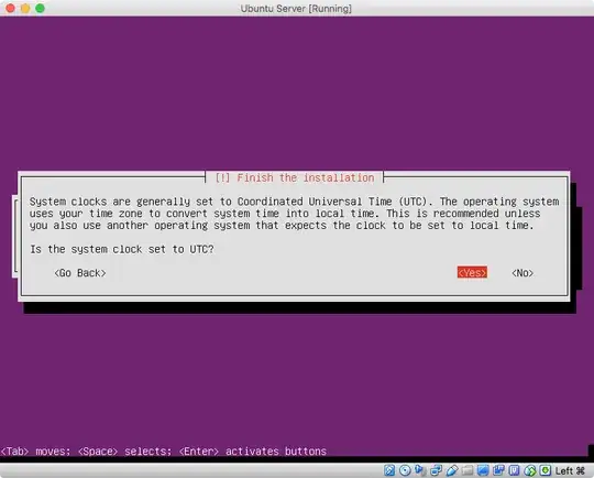

  8. In the next image, I chose the default <Yes>.
    f21

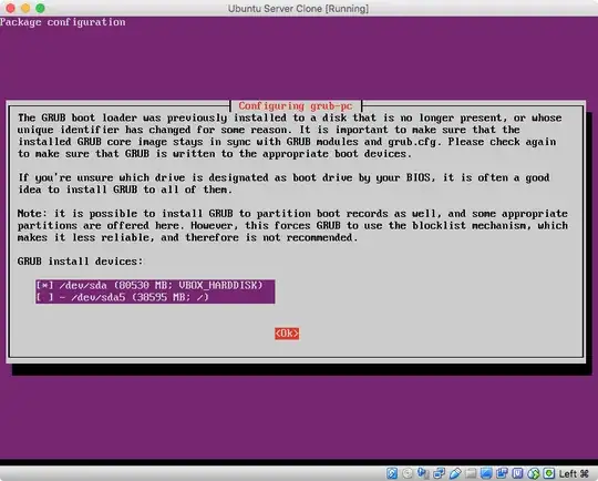

    You may not see this next image. When I did, I chose to install GRUB in /dev/sda, as shown below.
    f13
