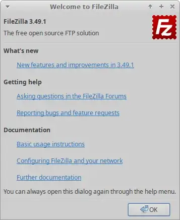

Now run FileZilla and it should be the newest version:
Hope this helps!
