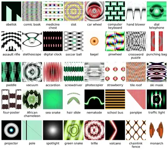

The following page/study demonstrates that the deep neural networks are easily fooled by giving high confidence predictions for unrecognisable images, e.g.
Evolved images that are unrecognisable to humans, but that state-of-the-art DNNs trained on ImageNet believe with >= 99.6% certainty to be a familiar object. This result highlights differences between how DNNs and humans recognise objects. Directly and indirectly encoded images
Evolving images to match DNN classes produces a tremendous diversity of images. The mean DNN confidence scores for these images is 99.12% for the listed class, meaning that the DNN believes with near-certainty that the image is that type of thing. Shown are images selected to showcase diversity from 5 independent evolutionary runs. The images shed light on what the DNN network cares about, and what it does not, when classifying an image. For example, a school bus is alternating yellow and black lines, but does not need to have a windshield or wheels

First up, those images (even the first few) aren't complete trash despite being junk to humans; they're actually finely tuned with various advanced techniques, including another neural network.
The deep neural network is the pre-trained network modeled on AlexNet provided by Caffe. To evolve images, both the directly encoded and indirectly encoded images, we use the Sferes evolutionary framework. The entire code base to conduct the evolutionary experiments can be download [sic] here. The code for the images produced by gradient ascent is available here.
Images that are actually random junk were correctly recognized as nothing meaningful:
In response to an unrecognizable image, the networks could have output a low confidence for each of the 1000 classes, instead of an extremely high confidence value for one of the classes. In fact, they do just that for randomly generated images (e.g. those in generation 0 of the evolutionary run)
The original goal of the researchers was to use the neural networks to automatically generate images that look like the real things (by getting the recognizer's feedback and trying to change the image to get a more confident result), but they ended up creating the above art. Notice how even in the static-like images there are little splotches - usually near the center - which, it's fair to say, are triggering the recognition.
We were not trying to produce adversarial, unrecognizable images. Instead, we were trying to produce recognizable images, but these unrecognizable images emerged.
Evidently, these images had just the right distinguishing features to match what the AI looked for in pictures. The "paddle" image does have a paddle-like shape, the "bagel" is round and the right color, the "projector" image is a camera-lens-like thing, the "computer keyboard" is a bunch of rectangles (like the individual keys), and the "chainlink fence" legitimately looks like a chain-link fence to me.
Figure 8. Evolving images to match DNN classes produces a tremendous diversity of images. Shown are images selected to showcase diversity from 5 evolutionary runs. The diversity suggests that the images are non-random, but that instead evolutions producing [sic] discriminative features of each target class.

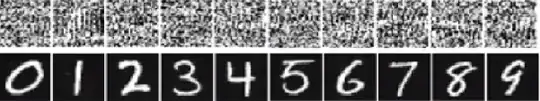

Changing an image originally correctly classified in a way imperceptible to humans can cause the cause DNN to classify it as something else.
In the image below the number at the bottom are the images are supposed to look like the digits But the network believes the images at the top (the one like white noise) are real digits with 99.99% certainty.

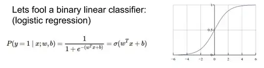

Let me give you a concrete example how to fool a neural network. To make it compact, I'm going to use a very simple logistic regression network with one nonlinearity (sigmoid). It takes a 10-dimensional input x, computes a single number p=sigmoid(W.dot(x)), which is the probability of class 1 (versus class 0).
logistic regression

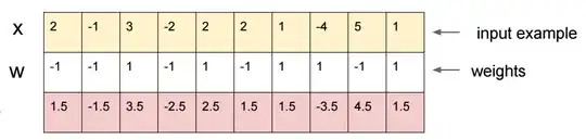

Suppose you know W=(-1, -1, 1, -1, 1, -1, 1, 1, -1, 1) and start with an input x=(2, -1, 3, -2, 2, 2, 1, -4, 5, 1). A forward pass gives sigmoid(W.dot(x))=0.0474 or 95% probability that x is class 0 example.
x and W
We'd like to find another example, y, which is very close to x but is classified by the network as 1. Note that x is 10-dimensional, so we have the freedom to nudge 10 values, which is a lot.
Since W[0]=-1 is negative, it's better for to have a small y[0] to make a total contribution of y[0]*W[0] small. Hence, let's make y[0]=x[0]-0.5=1.5. Likewise, W[2]=1 is positive, so it's better to increase y[2] to make y[2]*W[2] bigger: y[2]=x[2]+0.5=3.5. And so on.
x, W and y
The result is y=(1.5, -1.5, 3.5, -2.5, 2.5, 1.5, 1.5, -3.5, 4.5, 1.5), and sigmoid(W.dot(y))=0.88. With this one change we improved the class 1 probability from 5% to 88%!

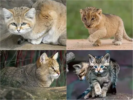

Test your own knowledge: Which animal in the grid below is a Felis silvestris catus, take your time and no cheating. Here's a hint: which is a domestic house cat?
Which is a domestic house cat?

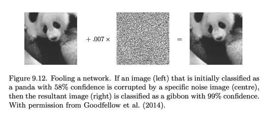

Neural networks are easily fooled, provided you know how to fool them.
Consider a linear network with an input layer and an output layer, which has an error function E (we don't need hidden layers to show how to fool a network). For a given input image x, E measures the (squared) difference between the network's output y and the desired (correct) output.
The output unit’s state y is given by the inner product of x with the output unit’s weight vector w,so that
y=w·x.
If we change x to x′ by adding ∆x then the output will change by ∆y to
y′ = w·x+w·∆x (9.4)
   = y + ∆y. (9.5)
Notice that ∆x defines a direction in the input space; the question is, which direction ∆x will have most impact on y?
By definition, a change in x in the direction ∇E produces the largest possible change in y. An adversarial image x' is constructed by taking the derivative ∇E of E with respect to the input image x, that is,
   x′ = x + ε∇E,
where ε is a small constant. By definition, ∇E is the direction of steepest ascent, so the modification ε∇E to x will alter y more than a change in any other direction.

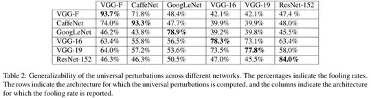

This type of images you are referring to are called adversarial perturbations, (see 1, and it is not limited to images, it has been shown to apply to text too, see Jia & Liang, EMNLP 2017. In text, the introduction of an irrelevant sentence which doesn't contradict the paragraph has been seen to cause the network to come to a completely different answer (see see Jia & Liang, EMNLP 2017).
The reason they work is due to the fact that neural network view images in a different way from us, coupled with the high dimentionality of the problem space. Where we see the whole picture, they see a combination of features which combine to form an object(Moosavi-Dezfooli et al., CVPR 2017). According to perturbation generated against one network has been seen to have high likelihood to work on other networks:
perturbations
In the figure above, it is seen that The universal perturbations computed for the VGG-19 network, for example, have a fooling ratio above 53% for all other tested architectures.
So how do you deal with the threat of adversarial perturbations? Well, for one, you can try to generate as many perturbations as you can and use them to fine-tune your model. Whist this somewhat solves the problem, it doesn't solve the problem entirely. In (Moosavi-Dezfooli et al., CVPR 2017) the author reported that, repeating the process by computing new perturbations and then fine-tuning again seems to yield no further improvements, regardless of the number of iterations, with the fooling ratio hovering around 80%.
