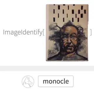

I've uploaded a picture to Wolfram's ImageIdentify of graffiti on the wall, but it recognized it as 'monocle'. Secondary guesses were 'primate', 'hominid', and 'person', so not even close to 'graffiti' or 'painting'.
Is it by design, or there are some methods to teach a convolutional neural network (CNN) to reason and be aware of a bigger picture context (like mentioned graffiti)? Currently it seems as if it's detecting literally what is depicted in the image, not what the image actually is.
Wolfram's Image Identify: monocle/graffiti

Wolfram's image id system is specifically meant to figure out what the image is depicting, not the medium.
To get what you want you'd simply have to create your own system where the training data is labeled by the medium rather than the content, and probably fiddle with it to pay more attention to texture and things as such as that. The neural net doesn't care which we want - it has no inherent bias. It just knows what it's been trained for.
That's really all there is to it. It's all to do with the training labels and the focus of the system (e.g. a system that looks for edge patterns that form shapes, compared to a system that checks if the lines in the image are perfectly computer-generated straight and clean vs imperfect brush strokes vs spraypaint).

If I look at the image, I can kind of see a monocle as part of the image. So one part of this is that the classifier is ignoring much of the image. This could be called a lack of "completeness", in the sense used here (a computer vision paper on image summarization).
One way to discover these sorts of failure modes is adversarial images, which are optimized to fool a given image classifier. Building on this, the idea of adversarial training is to simultaneously train competing "machines", one trying to synthesize data, the other trying to find weaknesses in the first one.
