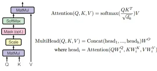

Both Figure 2 of the paper and equations explaining Attention and Multihead attention start with $Q$,$K$,$V$ already there :

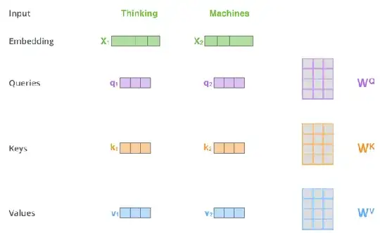

I also see some answers (eg this one on the same question) which say that $Q$, $K$, $V$ are the result of multiplication of the input embedding with some matrices $W$. This is also what is shown in the popular blog post The Illustrated Transformer :
These "projection" matrices ($W^Q$, $W^K$, $W^V$) do seem to appear in the the definition of attention in the definition of $head_i$ (see top figure), but according to that equation, these matrices are multiplied by $Q$, $K$, $V$ (still appearing out of thin air, so the problem of their definition remains) and so the resulting product can't also be $Q$, $K$, $V$.
