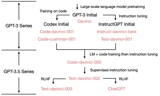

I'll complement nbro's answer with this great visual summary by Yao Fu <yao.fu@ed.ac.uk>:

ChatGPT has not been trained from scratch. ChatGPT is a fine-tuned version of a model from the GPT-3.5 series. OpenAI writes
ChatGPT is fine-tuned from a model in the GPT-3.5 series, which finished training in early 2022. You can learn more about the 3.5 series here.
Which models are in the GPT-3.5 series? You can read more about that in the linked blog post.
GPT-3.5 series is a series of models that was trained on a blend of text and code from before Q4 2021. The following models are in the GPT-3.5 series:
  • code-davinci-002 is a base model, so good for pure code-completion tasks
  • text-davinci-002 is an InstructGPT model based on code-davinci-002
  • text-davinci-003 is an improvement on text-davinci-002
So, ChatGPT must be a fine-tuned version of one of these 3 models, assuming the information in their site is accurate and up-to-date.
