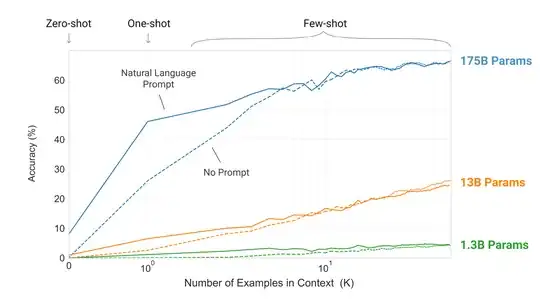

It is just one huge model which performs autoregressive text generation. The ability to perform a wide variety of task, defined at inference time is called in-context learning and was introduced in the GPT-3 paper.
The underlying idea is that during self-supervised pretraining, the model "sees" a huge variety of sequences and tasks, and learns to recognize very high-level patterns which identify the tasks (i.e the model is able to recognize the task even if we specify a different syntax ), and how the tasks are performed. This knowledge is used at inference time to perform the correct task.
This ability is largely dependent with model size and emerges at hundreds of billions of parameters in-context learning emergent ability
The task to perform is inferred from the context, i.e the text which specifies the desired task. The context may be composed of a description of the task, followed by
  • A few examples of desired output (few-shot approach)
  • Only of the structure the output needs to follow (zero-shot approach).
