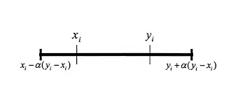

BUT, from my experience, I'd say that 90% of crossovers and mutation on real numbers genotypes are solved using the BLX-α algorithm.
Crossover:
BlX-α algorithm range
This algorithm is really simple. Given the parents X and Y and an α value (inside the range [0,1], generally around 0.1/0.15, but it depends by the problem), For each gene of your genotype:
  1. extract the genes xi and yi
  2. find the minimum and the maximum values
  3. the new gene will be a random number in the interval [min - range * α, max + range * α]

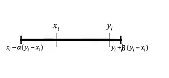

A variation of this algorithm is the BLX-αβ, in which we take into account which parent performed better and use two constants (α > β) to increase the probabilities that the new value will be closer to the one of the fittest parent
BLX-αβ algorithm range
