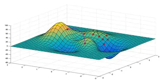

If you see this graphically you'll discover that the fitness function is just describing an area (or line or volume, depending on the grade) on our space and we are randomly dropping individuals on it, awarding the ones that fell higher than the others. We then try to modify the genomes of these guys to move them towards peaks of this fitness function. Crossover vs mutation, I did this image, feel free to use it.
In practice the fitness function is our world, our ground truth and we are exploring it.
