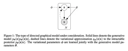

The VAE models the following directed graphical model (figure 1 from the original VAE paper)
So, you have 2 sets of parameters, $\boldsymbol{\phi}$ and $\boldsymbol{\theta}$, and 2 random variables, $\mathbf{z}$ (latent r.v.) and $\mathbf{x}$.
How can you view this graphical model (in figure 1 above) as a generative model?
  1. First, a sample $\mathbf{z}^{(i)}$ is generated from the (variational) probability distribution $q_{\boldsymbol{\phi}}(\mathbf{z} \mid \mathbf{x})$
  2. Then, a sample $\mathbf{x}^{(i)}$ is generated from $p_{\boldsymbol{\theta}}(\mathbf{x} \mid \mathbf{z}^{(i)})$
Now, more concretely, let's assume that we have a dataset $\mathbf{X}=\left\{\mathbf{x}^{(i)}\right\}_{i=1}^{N}$ of $N$ i.i.d. samples of the random variable $\mathbf{x}$. So, each of these $\mathbf{x}^{(i)}$ has been generated as follows
  1. a sample $\mathbf{z}^{(i)}$ is generated from some prior distribution $p_{\boldsymbol{\theta}}(\mathbf{z})$
  2. a sample $\mathbf{x}^{(i)}$ is generated from some conditional distribution $p_{\boldsymbol{\theta}}(\mathbf{x} \mid \mathbf{z}^{(i)})$.
Now, in the VAE, the encoder represents $q_{\boldsymbol{\phi}}(\mathbf{z} \mid \mathbf{x})$, while the decoder represents $p_{\boldsymbol{\theta}}(\mathbf{x} \mid \mathbf{z})$. If you want to train a VAE, you also need to make an assumption about $p_{\boldsymbol{\theta}}(\mathbf{z})$, for example, you can assume $p_{\boldsymbol{\theta}}(\mathbf{z}) = \mathcal{N}(\mathbf{z} ; \mathbf{0}, \mathbf{I})$. Once trained, you use the variational distribution (encoder) as the prior from which you sample $\mathbf{z}^{(i)}$ (although we train the VAE as if the variational distribution is an approximation of the true/unknown/intractable posterior given a usually fixed prior and the likelihood/decoder), in order to sample $\mathbf{x}^{(i)}$. This is not wrong. In fact, this is just how you usually do Bayesian statistics. You have a prior and a likelihood (and maybe a marginal), then you compute the posterior, which then becomes the new prior. So, if you had more data, you could learn a new variational distribution $q'_{\boldsymbol{\phi}}(\mathbf{z} \mid \mathbf{x})$ by assuming that your new prior is $q_{\boldsymbol{\phi}}(\mathbf{z} \mid \mathbf{x})$.
If you keep in mind the following equation
$$p_{\boldsymbol{\theta}}(\mathbf{x}, \mathbf{z})=p_{\boldsymbol{\theta}}(\mathbf{z}) p_{\boldsymbol{\theta}}(\mathbf{x} \mid \mathbf{z})$$
it should remind you why the VAE can be viewed as a generative model.
