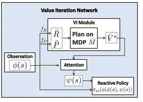

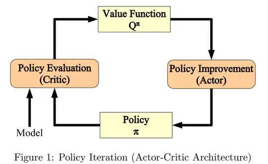

Architecture Value iteration networkVI Architecture reference Policy iteration architecture PI Architecture Reference
