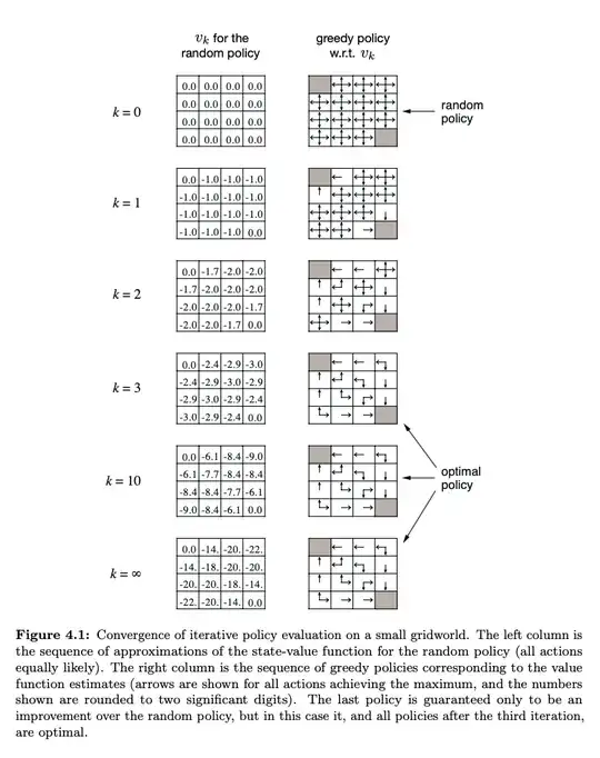

Barto and Sutton's book provide an example. See figure 4.1 on page 77 (p. 99 of the pdf). For completeness, here's a screenshot of the figure.
