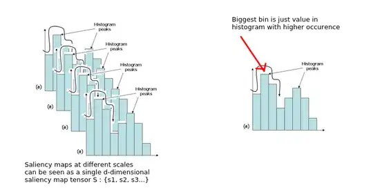

  1. I did not understand what the authors meant by the term "bin" in section 3.2 line 5 where it is stated, "The hill-climbing algorithm can be seen as a search window being run across the space of the d-dimensional histogram to find the largest bin within that window."

"Bin" is just one of the groups you divide an histogram into. The authors say to compute one histogram (it is used to approximate probability density functions) and then select the value of the biggest bin (the range of values with more occurrences.
So if you compute 1 histogram (search how to do it in google, there are plenty of implementations I use the openCV one) per saliency map, you could say you are computing d-dimensional histogram (one dimension per saliency maps)
