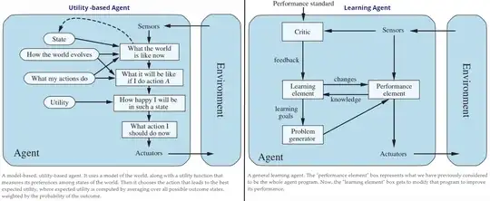

For the purpose of illustration, the structure of a utility-based agent and that of a learning agent are presented in the figure:
Left: Utility-based agent, Right: Learning agent
What boggles my mind is figuring out the actual difference and interaction between performance standard and performance measure, which is perhaps related to those between learning agents and other ones. Here are my thoughts thus far:
  1. Other agents aim for maximizing the performance measure, causing them to do perfect actions. On the other hand, learning agents have the freedom of doing sub-optimal actions, which allow them to discover better actions on the long run using the performance standard.
  2. Through the performance standard's feedback (which comes from the critic as shown in the figure), the learning agent can also learn a utility function or reflex component.
For providing examples, the book states that giving tip to an automated taxi is considered a performance standard. And also
hard-wired performance standards such as pain and hunger in animals can be understood in this way.
But I am still not sure about the discrepancy and interaction between the performance measure and performance standard. For instance, in the automated taxi, when confronting a road junction, the utility-based agent chooses a path that maximizes its utility function. The learning agent, however, must check different roads and after testing them, it receives feedback from outside so that eventually it would detect the user's preference.
But what if we wrap a learning agent around a utility-based agent in such a condition? Which has more effect, the utility function from inside, or the performance standard from outside (critic)? If they happen to contradict each other, which one would have the prevalent effect?

In section 2.4, they write about the performance standard
The critic tells the learning element how well the agent is doing with respect to a fixed performance standard. The critic is necessary because the percepts themselves provide no indication of the agent’s success. For example, a chess program could receive a percept indicating that it has checkmated its opponent, but it needs a performance standard to know that this is a good thing; the percept itself does not say so. It is important that the performance standard be fixed. Conceptually, one should think of it as being outside the agent altogether because the agent must not modify it to fit its own behavior
That's why it appears outside the agent in the diagram.
On the next page, they write
In a sense, the performance standard distinguishes part of the incoming percept as a reward (or penalty) that provides direct feedback on the quality of the agent’s behavior.
In RL, this would be represented as $p = (o, r)$, i.e. the percept $p$ is composed of the observation $o$ and reward/performance $r$.
