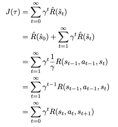

I like to think of these formulations as equivalent a bit differently. Intuitively, for any reward function $R(s,a,s')$ you can always build an equivalent MDP that allows rewards to come in one timestep later than in the original MDP that uses a $R(s)$ notation, with the $R(s,a)$ case following naturally.
Formal derivation
Let $M$ be an MDP with reward function $R(s,a,s')$ and transition function $T(s,a,s')$. We will now convert this into an MDP $\hat{M}$ with a reward function of shape $R(s)$ and show that any trajectory in $M$ has the same discounted reward in $\hat{M}$.
Let the state space in $\hat{M}$ be $\hat{s}_t = (s_{t-1}, a_{t-1}, s_t)$ and the reward be $\hat{R}(\hat{s}_t)=\frac{1}{\gamma} R(s_{t-1}, a_{t-1}, s_t)$. To handle edge cases, assume that $\hat{R}(\hat{s}_0)=0$ and after every terminal state $s_T$ add a transition to an absorbing state $\hat{s}_{T+1}$ so that the final reward can be collected. We then have
This implies that under the new MDP $\hat{M}$, trajectories all still have the same discounted return. The only conceptual differences to note is that reward is collected one timestep later than in $M$ and that the policy now has access to $(s_{t-1}, a_{t-1})$ when taking its decision, both of which do not leak any useful or actionnable information for what to do in state $s_t$ by the assumption that $T$ and $R$ are Markovian in $M$.
The same argument applies to a $\hat{R}(\hat{s},a)$ reshaping instead by posing $\hat{R}(\hat{s},a) = \hat{R}(\hat{s})$ as above.
I personally find this way of showing the equivalence more satisfying because it does not imply that rewards are deterministic for $s$ or $(s,a)$ in the original MDP $M$ as you can do with taking the expectation over next states. This way you truly have the property that the way in which you reached state $s'$ changes your overall reward for instance.
