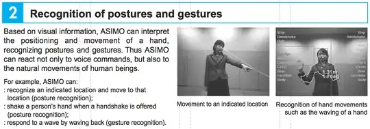

I'd like to investigate the possibility of achieving similar recognition as it's in Honda's ASIMO robotp.22 which can interpret the positioning and movement of a hand, including postures and gestures based on visual information.
Here is the example of an application of such a recognition system.
Honda's ASIMO robot - Recognition of postures and gestures based on visual information
Image source: ASIMO Featuring Intelligence Technology - Technical Information (PDF)
So, basically, the recognition should detect an indicated location (posture recognition) or respond to a wave (gesture recognition), like a Google car does it (by determining certain patterns).
Is it known how ASIMO does it, or what would be the closest alternative for postures and gestures recognition to achieve the same results?
