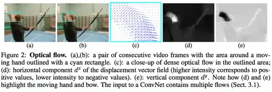

This Oxford study from 2014 also uses a similar approach, but with two-stream CNN which incorporates spatial and temporal networks which can achieve good performance despite having limited training data. It recognises action from motion in the form of dense optical flow. For example:
Optical flow using ConvNets

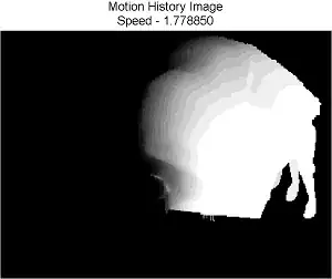

Another study from 2007 demonstrates a method by detecting human falls based on a combination of motion history and human shape variation by analysing the video frames. It uses Motion History Image (MHI) to quantify the motion of the person.
Motion history image (MHI)
Source: harishrithish7/Fall-Detection at GitHub

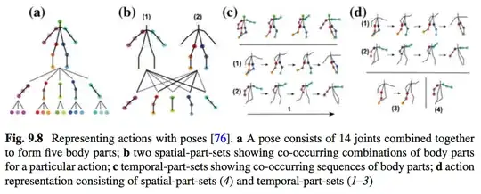

  • Spatio-Temporal Structures of Human Poses
    K. Soomro and A.R. Zamir - action recognition - figure

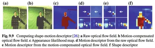

  • a joint shape-motion

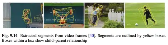

  • Hierarchical Space-Time Segments
    K. Soomro and A.R. Zamir - Extracted segments from video frames

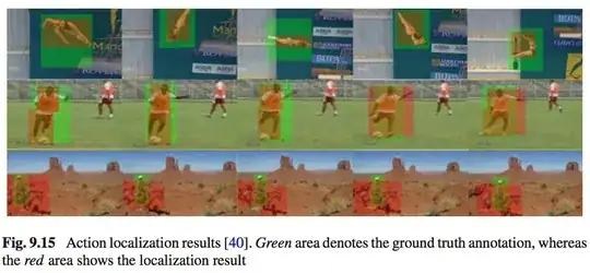

  • Spatio-Temporal Deformable Part Models (SDPM)
    K. Soomro and A.R. Zamir - Action localization results

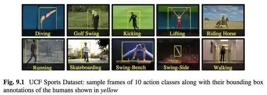

Here are the results based on training of 10 action classes based on the UCF sports dataset:
UCF Sports Dataset: sample frames of 10 action classes along with their bounding box annotations of the humans shown in yellow
Source: Action Recognition in Realistic Sports Videos.
