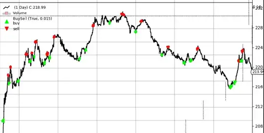

I am working to build a deep reinforcement learning agent which can place orders (i.e. limit buy and limit sell orders). The actions are {"Buy": 0 , "Do Nothing": 1, "Sell": 2}.
Suppose that all the features are well suited for this task. I wanted to use just the standard "Profit & Loss" as a reward, but I hardly thought to get something similar to the above image. The standard P&L will simply place the pair (limit buy order, limit sell order) on every up movement. I don't want that because very often it won't cover the commission and it is not a good indicator to trade manually. I would be interested that the agent can maximize the profit and give me a minimum profit of $100 on every pair (limit buy order, limit sell order).
I would be interested in something similar to the picture below.
Is there a reward function that could allow me to get such a result? If so, what is it?
