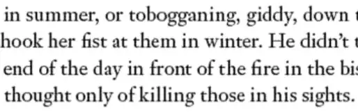

A reading a modern paperback book on Amazon I came across this: Ligatures in modern novels
As I was reading, I had to look twice at the words "fist" and "fire," but sure enough, the print was not an "f" and "i", but the fi ligature. Look at the word "front" to prove the point. This, in a novel printed in 2016.
