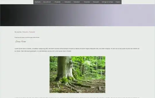

I created a (quick and dirty, sorry for that) test page where I included this script:
Here we see the test page with the included printfriendly button:
printfriendly button included

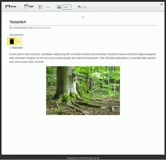

Here is the page setup dialog which appears after one clicked the print button. You are able to delete various parts of the page you want to print:
printfriendly page setup

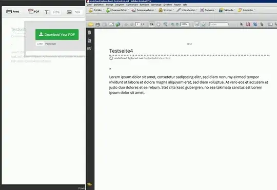

This is the output pdf generated by the script:
printfriendly pdf result

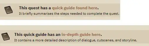

In a lot of ways, quests on online games like RuneScape are very much like recipes. I think you could take a page out of their book. Compare the following two pages:
https://oldschool.runescape.wiki/w/Dragon_Slayer https://oldschool.runescape.wiki/w/Dragon_Slayer/Quick_guide
At the top of each is a snippet that explains that there is a quick guide, or if you're on the quick guide and want the fuller description, that that exists as well. I think this paradigm would work very well for the recipes.
One potential issue here is that you have to essentially maintain two separate articles. But one of them, by definition, is pretty slimmed down, so it shouldn't be too much of an issue. I know this is something you specifically said you didn't want, but I wanted to throw it out there as a form of "When this problem came up, here's a solution for it in the wild that seems to actually work well."
