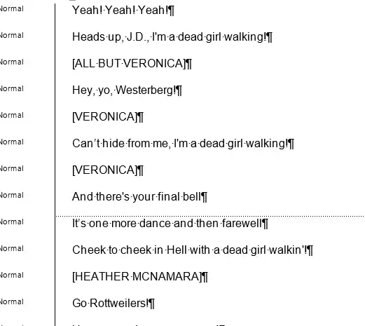

Drafts View, "no" styles
1) I copied some lyrics to be my "script". I chose View, Draft, to create that left-view. Shift-F1 is another great tool for knowing layout. This is my starting with a text snippet all in normal mode

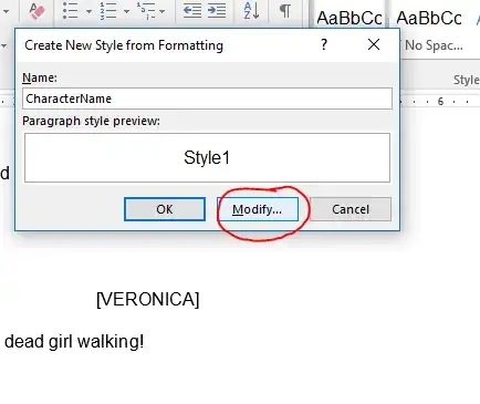

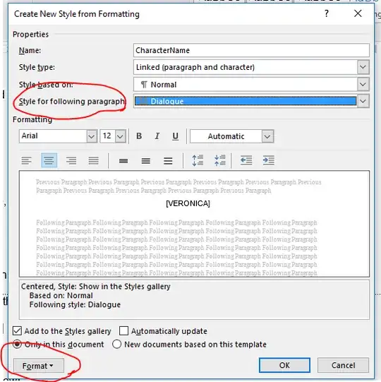

Create A Style

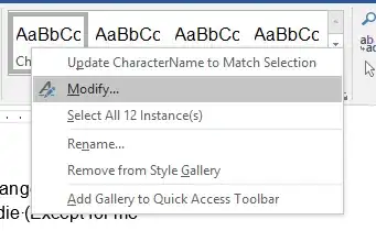

2) I manually centered one line, then selected it as my "model" - then on the Styles Menu, I chose Create-A-Style to get started Image shows using context-menu to start editing a Style
Name the Style & Start to Modify
3)You can give any style any name. You can also change more properties within this.
Closeup of Create-Style, directing users to click "modify"
Styles That Can Be Buddies 4)Most of the time, after a Character Name, there's dialog - so I previously made that style (Normal, but indented .5" on L & R, smaller space before/after paragraphs.) So you can select a "Next Style" button as shown here, and then use the Modify button at the bottom, to see various other elements to change.
Close up of Style Edit page, highlighting "Style for Following Paragraph" and "Modify" buttons
Modify Options

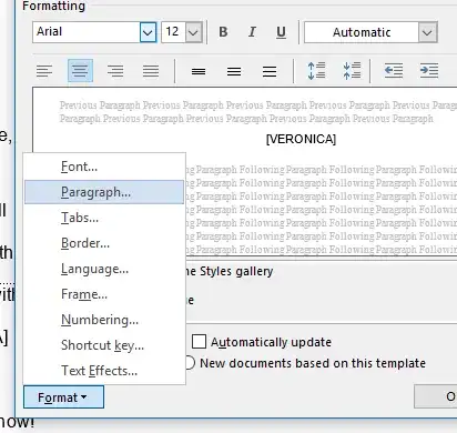

5) In the Modify box, you can go to many areas - you may want to add a Shortcut Key so you can turn on Character Name formatting at the start of said line! We want to do paragraph options now closeup of Modify drop-down menu

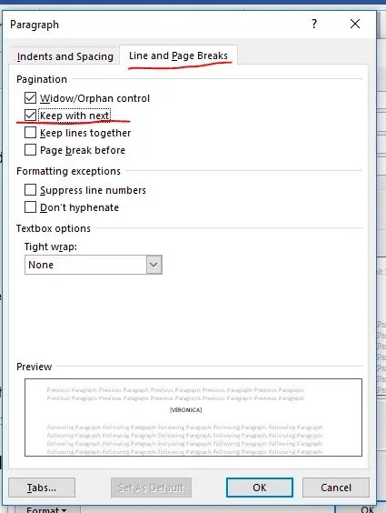

Paragraph Options, 2nd Tab
6) The big feature you want is "Keep with Next" (You may want to also have Scene Breaks start a new page - use "Page Break Before" then.)
Paragraph Tab, 2nd tab, highlighting Keep With Next

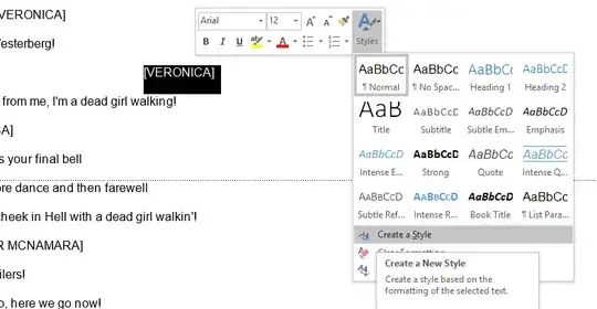

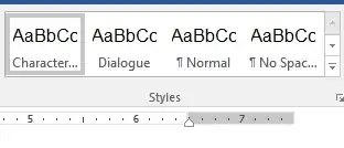

Style Gallery
7) Hey, there are our Styles in the gallery! Styles Gallery closeup - "Character name" is first style

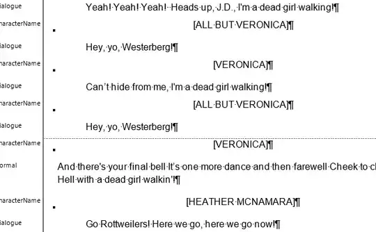

8) Screenshot of the script, now with those character and dialog Styles added. Note there's a page break here -- I played with adding blocks of text - the character-name stayed with the dialog! (But Things seem a little unbalanced, hmmmm...)
Drafts View, showing Styles added over a page break

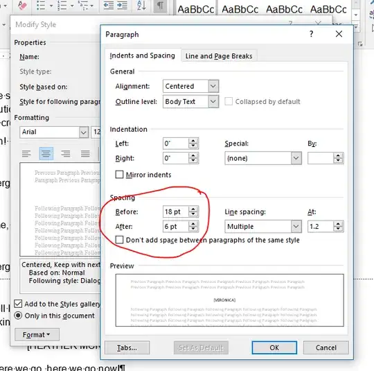

9) So let's fix that spacing issue -- too little space between blocks and the next character name. (It's nice to know that once a style exists, it can still be modified as needed) Modify Style from Style Gallery
Back to Style Paragraphs
10) Just the front part, playing with spacing instead of adding unneeded "enter"s to add spaces
Modify Style -- Paragraph Properties

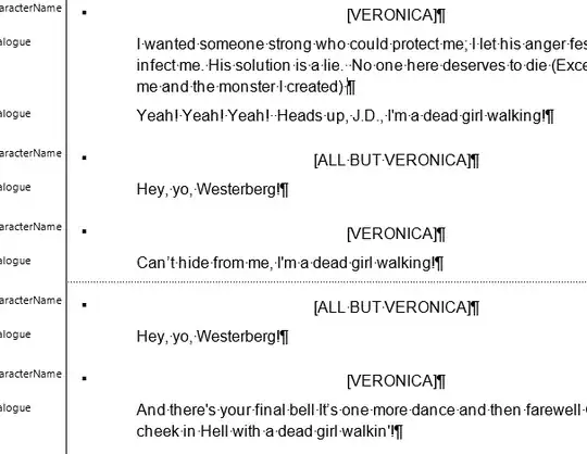

Really Done
Final view of script in draft-view with modified styles
