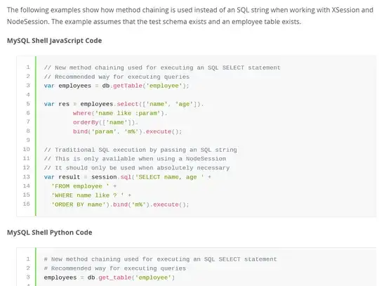

Here is an example of how I want it to look, with syntax highlighting:
Is this possible with Scrivener? I know I could just insert images of the code, but I don't want to follow this approach, as when I export the PDF it can make the life of the reader much harder (maybe a reader just want to copy and paste), and it can also make my life much harder, as if I want to change a code snippet I can't just edit within scrivener.
