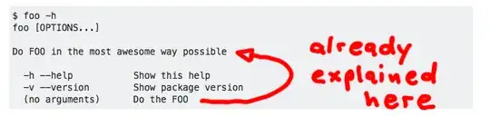

I must misunderstand your question, but it seems to me that the function call without argument is already explained in the function description:
