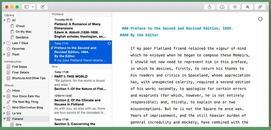

The main thing writers need is to organize structure. I find that Ulysses 3 is the closest to getting it right. You write small chunks of text and then you can arrange them in any order you want on a sidebar.
Ulysses showing list of sections and text of selected section
The problem is that it's Mac only and not very programmable.
I am surprised there is no open source option for something like this. Is this possible on Emacs? I have seen sidebars but none allow you to read a bunch of text files and then order in any way you want.

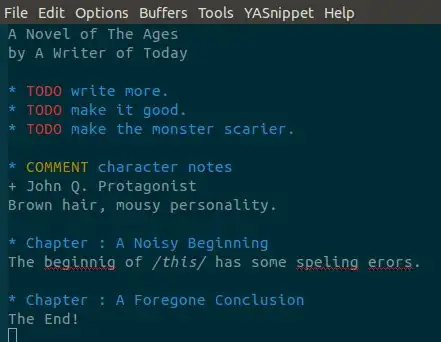

  • org-mode : This is an Emacs mode for organizing lists, and it's the reason I tried Emacs out in the first place. It works beautifully for large, complex manuscripts because it allows you to create heirarchies, all in plain text. Here's a screenshot of my environment: Emacs Screenshot
    These sections can be 'folded' and unfolded at will, and they can be shuffled around at will, too, all with keyboard shortcuts. Want to switch chapter 2 and chapter 10? Easy. Want to see the chapter titles only, and not the content? Scenes? Only some chapters and not others? You can do that, too. org-mode also supports the use of a keyword called TODO, for things you're working on. I use this to organize things I need to remember. You can also create COMMENT sections, which won't be exported, when you export.
