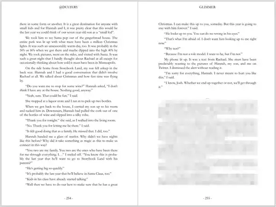

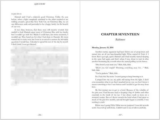

Far be it from me to disagree with the Scrivener staff, but I have been doing this very thing with my PDF. Here's the basics of my setup.
  • PDF output using Printing layout
  • In the Formatting section, Level 1 folders are configured to always start on a recto page. (Under the Section Layout button, then First Page tab.)
  • In the Page Settings section...
    • Header and Footer tab
      • My desired header and footer are typed in the center boxes
      • No header on first page and pages following page breaks is checked.
      • No header or footer on single pages is not checked.
    • First Pages tab
      • I put a single space in the header and footer center text boxes
      • Different first page header/footer is checked.
      • Page numbers count first pages is checked.
      • Start regular header and footer is set to Page 4.
    • Facing Pages tab
      • Same header and footer text from the first tab is in the center text boxes
      • Use facing pages is checked.
And here is how it comes out on mine...
Hope this helps.
Chapter Headers No Chapter Headers
