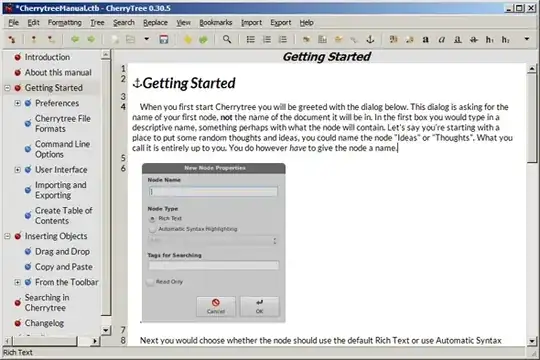

Consider CherryTree , it handles images elegantly (either embed or link). Then export to HTML, PDF.
    You've written three answers that mostly just mention the program "cherrytree". Are you in any way affiliated with them in any way? Why is this the best program to use? (Handling images elegantly doesn't really tell me much. Is the usage like the OP described?) If you have a moment please take the [tour] and visit the [help] to learn more about the site. Have fun! – Secespitus Jan 23 '18 at 15:39
  • No, I'm not affiliated. I just want to share my joy of using this program for storing lots of images. And I also like helping people. CherryTree is free and open source. There is no commercial interest whatsoever. CherryTree provides exactly what the OP asked for: "where I could just include the path to the file, and just have the image file in the same folder". – Vitaly Sazanovich Jan 23 '18 at 16:53
