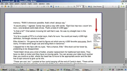

Using OpenOffice, which is free, but somewhat awkward, you may File/Insert a "frame", designate its alignment (page/paragraph/etc.) and position (left margin, right margin, outside mirrored, inside mirrored).
The text that you type inside this frame can be formatted just like anything else, size, color, etc.
You can insert picture(s) into this frame in addition to the text.
I don't have access to MS Word anymore, but this may be possible in that environment as well.
Chowzen
  • 325
  • BTW, when the frame is anchored to a paragraph, moving the paragraph moves the frame accordingly. Also, OOP outputs to PDF. – Chowzen Jun 03 '16 at 19:43
