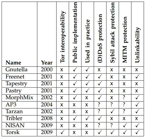

They also give a comparison of decentralized peer-to-peer overlay networks:
It is interesting to read their conclusion:
..we conclude that there is no fully decentralized system capable of offering Tor anonymity today. For the first time we document in detail, the amount of wasted effort and pain spent in decentralization. The current generation of technology lead by Tor still has room for improvement, while the next generation is only just appearing on the horizon. The major problems involving decentralization are excruciatingly difficult to overcome. None of the projects have succeeded in making the internet secure and private.
