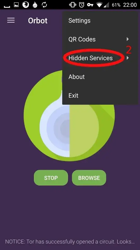

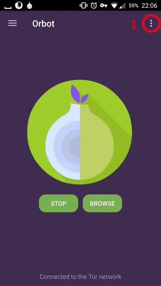

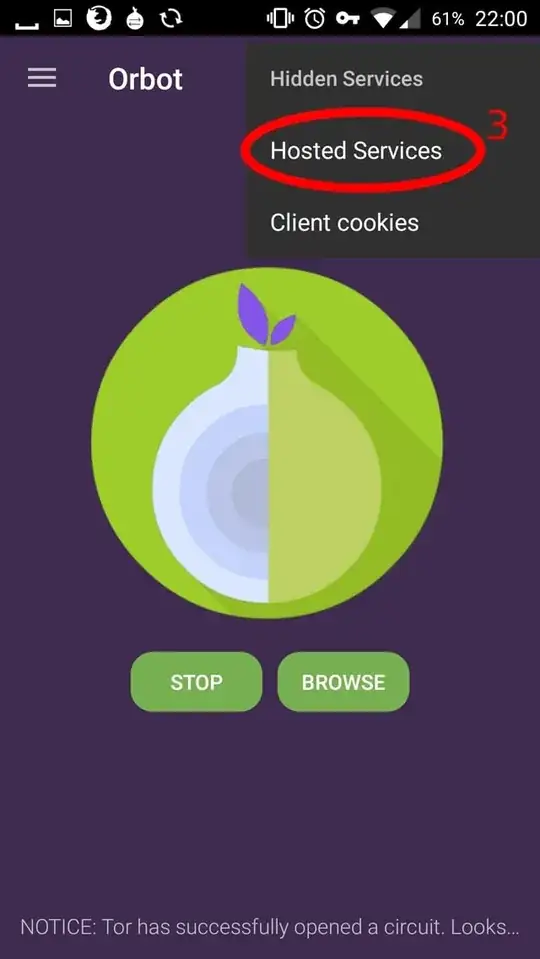

Starting with the current beta release of Orbot 15.4.0 beta-2, Orbot has a new menu which makes it very easy to add hidden services.
  1. Open settings menu
  1. Click on "Hidden Services"
  1. Click on "Hosted Services"

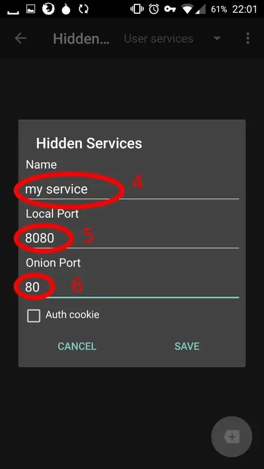

  1. Pick a name for your service
  2. Enter Port your service uses locally
  3. Select the port your service is reachable via .onion (choose 80 if it is a web service)

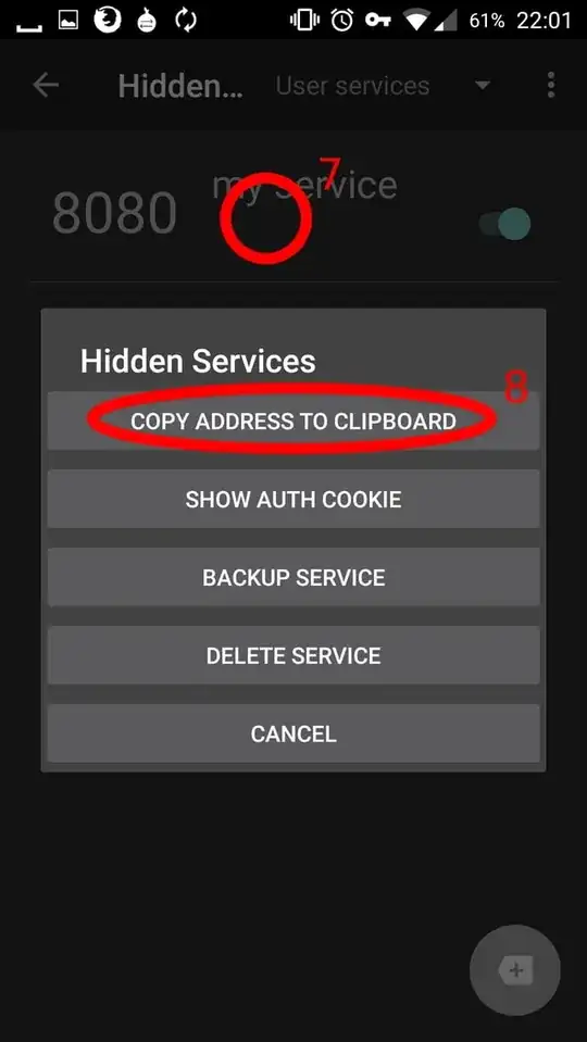

  1. Click on the newly created service in the list
  2. Copy the .onion address

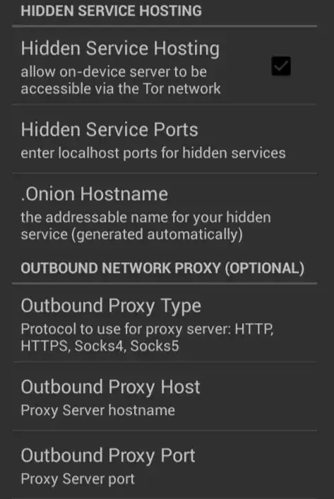

The first thing if you want to enable a hidden service on your Android phone is that you need Orbot and some application like a webserver or something similar. I assume you have configured a webserver which serves on port 8080.
Now go to the Orbot settings: Orbot settings for hidden services
Near the bottom you find the settings for hidden services. Activate the configuration for hidden services (Hidden Service Hosting) and click on the entry below (Hidden Service Ports). Here you enter the port number of your webserver (8080 in my example). Now close this dialogue and restart Tor. After some time you'll see a green onion again. Go to the settings again and click on .Onion Hostname. Now you'll see the name for your hidden service and can use Tor Browser to connect to it.
