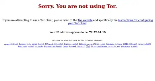

A strange issue started happening to me since about 2 weeks ago: I started noticing TBB home screens like this one:
Sorry. You are not using Tor.
The first time I thought it was some sort of synchronization problem between the beginning of activity of a new exit node in the network and its official adding to the Tor directory. So I just reloaded Tor and let it go. But then a few days later it happened another time, with a very-similar-but-different IP that came from the same network I guess (the first was 72.52.91.18, while the other 72.52.91.19). After that, another couple of times it showed up with the same initial IP. So I started being dubious, and I decided to find out what could it be when I had a free moment. So just a few minutes ago I took some info:
  • Their ISP seems to be Hurricane Electric. Its servers are from the same network, located near Livermore (California). Here's my whois: http://paste.ubuntu.com/6254724/
  • I also did a nmap, to verify whether they really had some kind of Tor service running, and it doesn't seem so.

Hilariously, just after my nmapping, I ran TBB and... there was it again, same IP!
So I made a screenshot and decided to share it with you.
What do you think?

You can use ExoneraTor to find out if a particular IP was running a Tor relay at a particular time. For example, according to ExoneraTor 72.52.91.19 was running an exit node on 2013-10-13. This lends support to the theory that the check error you saw may have been a false negative.
