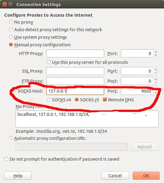

In order to resolve a .onion address, you will need to make your web browser use Socks5 remote DNS, since only the Tor system is aware of .onion addresses. You will need to configure your browser accordingly. Since I do not know what browser you are using, I will show a Firefox example (since TBB uses Firefox by default anyway):
