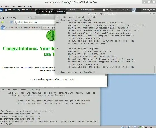

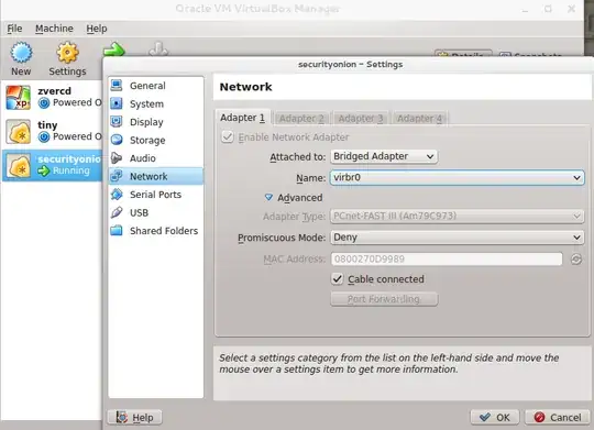

2) In VirtualBox you need only one settings to achieve this:
VirtualBox settings
Inside the VM, configure everything to use socks5 proxy, for example, chromium:
securityonion inside VirtualBox

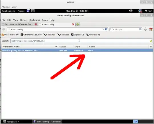

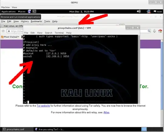

Don't forget to change default firefox settings about:config -> network.proxy.socks_remote_dns = True
kali in qemu / firefox dns proxy

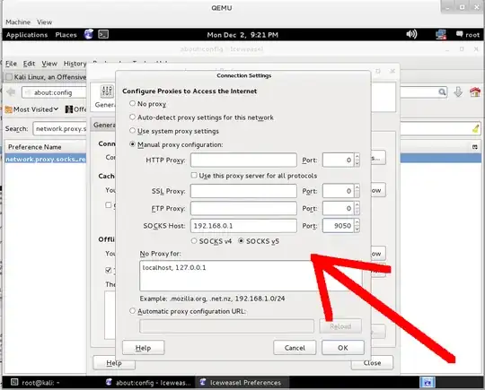

Set socks5 proxy: Edit -> Preferences -> Advanced -> Network -> Settings -> Manual proxy configuration -> SOCKS Host: 192.168.0.1 & Port: 9050
kali in qemu / proxy settings
Check your connection: http://check.torproject.org
kali in qemu / Success!
Configure /etc/proxychains.conf by adding only one string to the end of file: socks5 192.168.0.1 9050:
kali in qemu / proxychain

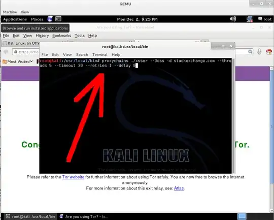

Now, you can start any program with prefix proxychain program.bin:
kali in qemu / ddos stackexchange via proxychain

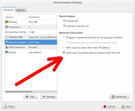

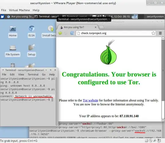

4) VMware:
VMware settings
That way, the VM will connect to the host machine, to VMware's internal virtual interface, vmnet1, only, no external network. Bind the SOCKS5 proxy to this interface by rinetd.
VMware with security onion inside
