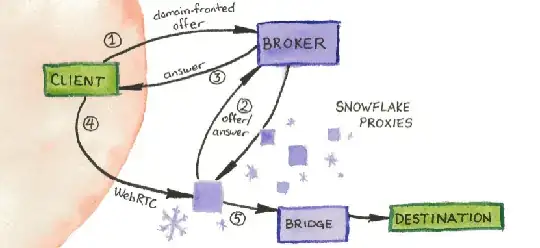

Looking at the schema here:
And looking at my log output, a successful connection seems to look like this:

Skimming through the source code, I think that the interesting ones are:
  • The "sdp offer" message seems to be the offer relayed by the broker (number (2) in the picture).
  • "Generating answer" would be the answer going back to the broker (number (2) in the picture).
  • "Connection successful" and and "OnOpen channel" seem to mean that the WebRTC connection was initiated (number (4) in the picture).
  • "Connected to relay" sounds like (5) in the picture.
  • I guess that you are mostly interested in the Throughput summary, which seems to summarize what went through your snowflake instance for a particular client.
