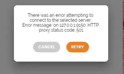

I'm trying to connect to a remote OpenVPN server using OpenVPN Connect Client on a Windows PC. The Open Connect Client has a proxy option in the GUI, for this I configured to use TOR as a proxy. IP 127.0.0.1 port 9051 I have kept the Tor browser open so that the port is available. No changes have been made to the torrc file.
Without the proxy the connection works fine.
However when I try to connect with the proxy. I get the following error.
Any clues as to what is going wrong here would be helpful.
Tor Browser runs a SOCKS proxy on port 9150, but OpenVPN Connect expects an HTTP proxy.
There are two types of HTTP proxies, GET proxies and CONNECT proxies. Tor only supports HTTP CONNECT proxies if you enable the HTTPTunnelPort option in your tor configuration file (the torrc file). I would think that OpenVPN expects an HTTP CONNECT proxy so I think this will work, but I can't find any actual documentation about what type it expects.
