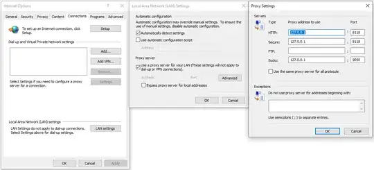

  3. I went into Internet Explorer >>> Internet options >>> Connections and set the proxy ports. See the image below for my setup.
Internet Options
What I found was that HTTPS sites work but HTTP ones don't. I get the following error message when I navigate to a HTTP website: “This is an HTTP CONNECT tunnel, not an HTTP proxy.”

According to https://gitlab.torproject.org/legacy/trac/-/issues/27821 , Tor will only support CONNECT proxies, not regular HTTP proxies. Try to use a different client or try to change some setting in IE itself so it can use HTTP CONNECT proxies.

Tor has a built-in HTTPS proxy for a long time, in old times it was a package converting the requests to SOCKS named polipo. Actually - just for your case it's still actual, because it will give you a HTTP proxy you asking for. Don't be afraid that it's no longer maintained: it's finished, no bugs found and it's 100% done. Try it! And there's nothing bad at all to have a HTTP, not HTTPS proxy - it's fine!
